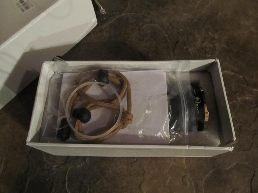

Gift-able box with heavy duty lanyard and manual included.

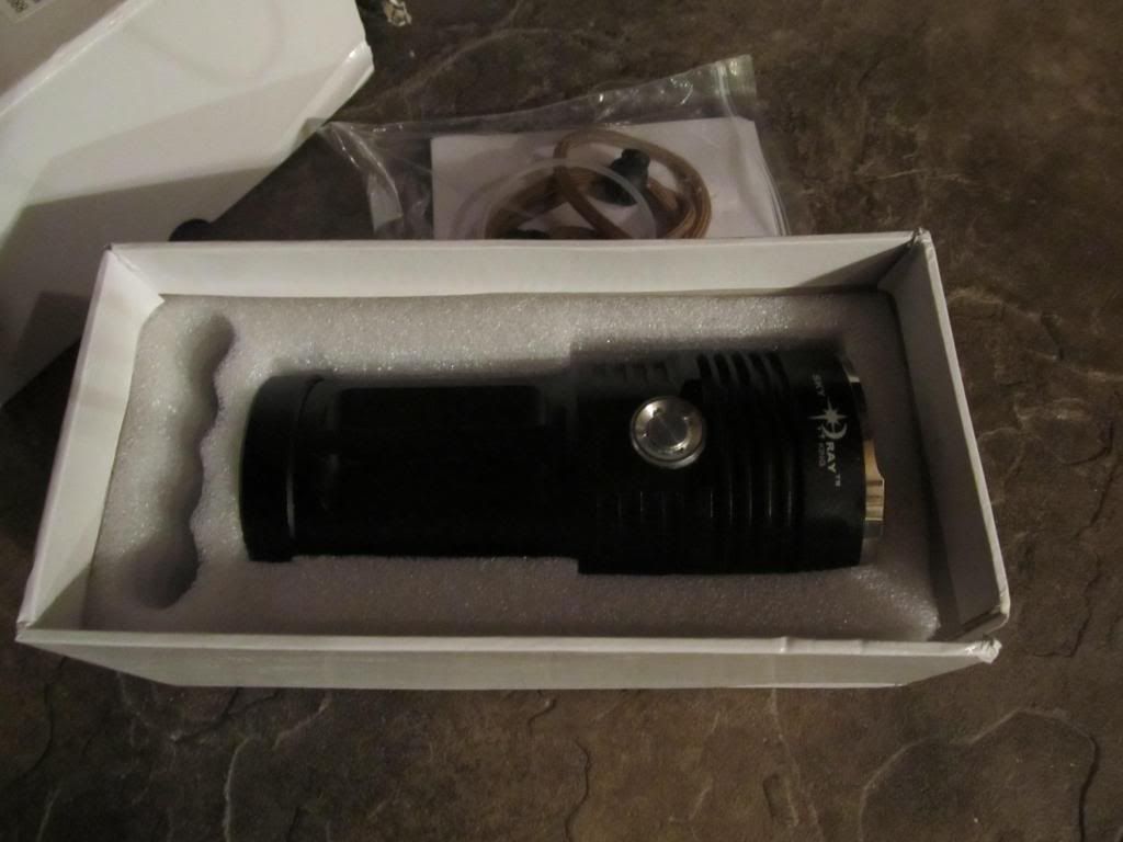

It arrived in a nice little box, adequately padded. The box suffered a bit of damage on the corner, but the light is unharmed.
