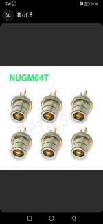

Note: Just because a Chinese seller says you are getting an ABC diode, doesn't guarantee that's what you'll really receive.
