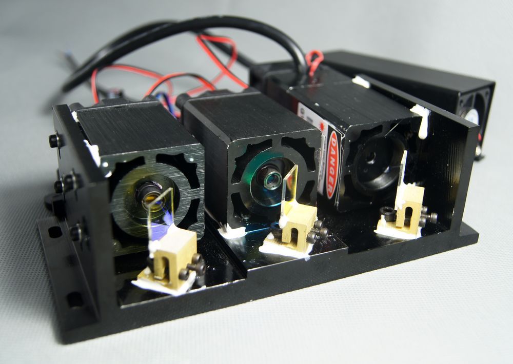

I have a laserlands RGB and it works well... I had to post a review on the laser but unfortunately I have been too busy this week and I wasn't able to actually start the review.
For my personal use it's a nice little object.
Here are some pics... review to come:
Norbyx,
I have the exact same unit. Unfortunately when mine warms up for a few seconds, the white shifts to yellow. I assume the green needs to be at a little lower power. I'm also assuming one of the three blue pots on that board might be able to help. I haven't messed with them yet. Just wondering if you have traced them out?
