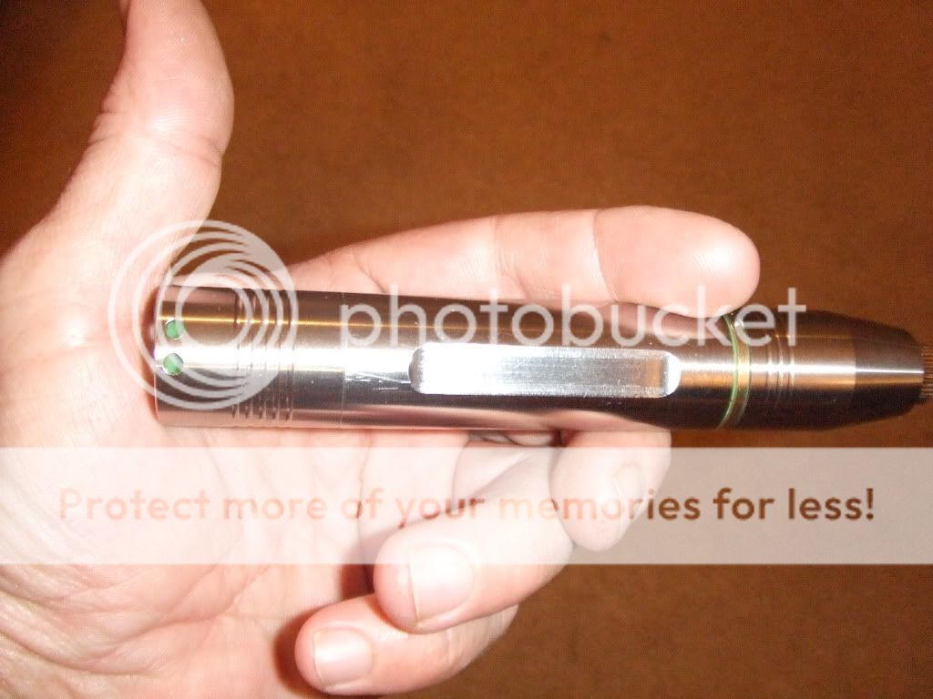

I just finished my latest 445nm build, in a host I haven't seen used before. I ordered it from deal extreme and it was supposed to be a Cree Ultrafire C5 Stainless Steel flashlight, but not surprisingly when it arrived it was not a Cree.
Anyway, I still love the host, maybe even more because it arrived with 2 milled down surfaces in the side and some carbage chinese lettiering, which ehgemus was kind enough to mill off the host for me. He also custom milled the heatsink for it.
And, it is nice and heavy and has a great feel to it.
Anyway, here's a few pics and a link to the dealextreme page for it, if anyone else wants to build one:
UltraFire C5 Stainless Steel CREE P3-8B 2-Mode 4700K LED Flashlight with Strap (1*18650) - Free Shipping - DealExtreme
Here's how it breaks down. I meant to snap a few shots before starting the build, but I forgot, so this is partially assembled
The host has a nice deep pill for your driver, and is constructed very well.
Here it is reassembled as a laser
And how about a beam shot?

Sorry about that. Mine was the Jade too though, and if you got it from delaextreme it's probably gonna have chinese writing on the cutout on the other side. But, it does mill off nicely.
Tell you what though, if you wanna mill a second heatsink when you do yours, I'll buy it from you, cause I'm gonna order another one.
That is nice. I got one of these hosts a while back but I couldn't get the pill out of it. I can't tell is it threaded? I thought they were threaded but mine is cranked in there so tight I have not gotten it loose yet. I just layed it aside for later while working on other builds. Thanks,
It is threaded. You may need to wrap it in cloth thoguh and loosen it in a vice or with pliers.
You'll need to come up with a battery contact board though. I just used one that I had from another host and grinded it down to fit.
Thanks man, I'll just get back on it cause I got it thinking it would make a cool looking laser, and yours is definitely cool :drool:!
