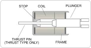

solenoids are either push or pull type. either way there is a stopper in there that limits the travel.
I googled the push type, it looks to me like they're arguably the same thing as a pull type. The coil pulls the metal into the center, and a tiny push pin pops out the other end.
