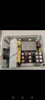

I put everything in the box for a test run. Space is quite limited. I'm thinking of putting two of those 600W (60V/10A) drivers connected in parallel, setting them to 30V and 9A. That way I'll have the option to include one or both together. That is, I will have an option for 50% power and 100% power.

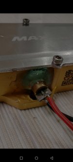

Be careful with the fiber because if it's all the way down and catches fire it will stain the last lens inside if you decided to leave them on. Can you upload a picture so I can see what you did?
Oh wait I didn’t burn it all the way I just burned it into the ferrule, how did you drill a hole without getting dust inside?
I put brand new disposable nylon bags inside. They are soft and can't hurt anything inside. I also put tape in front of them. That way all the shavings were at the front. Be very careful what you drill with. I drilled it on a lathe. That way there is no chance that the drill bit will suddenly go inside and break something. It was very difficult for me to drill through because in the center along the fiber there is something like very hard glass or whatever material it is. I don't know how it is with you, you never uploaded a picture so we can see what you are doing.

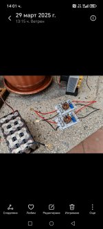

Today I was doing tests. I decided to put two drivers in parallel. That way I will be able to get 50% power and 100% power. Both are set to 30V and 9A. It turned out that I do not have a suitable BMS and so I ordered one up to 40A output. Mine are 12A. I will also put two 40A buttons for the water heater. Because the round ones I used do not last and are screwed up. Today I saw the full power of the laser for the first time and it is very powerful when it works at 18A
