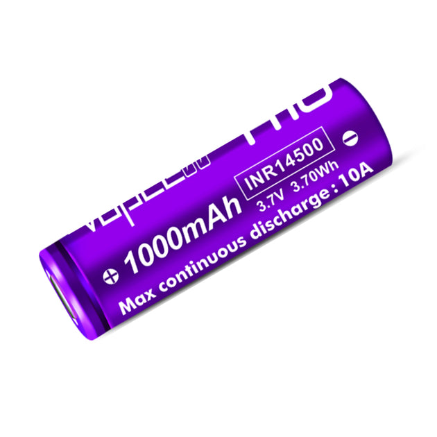

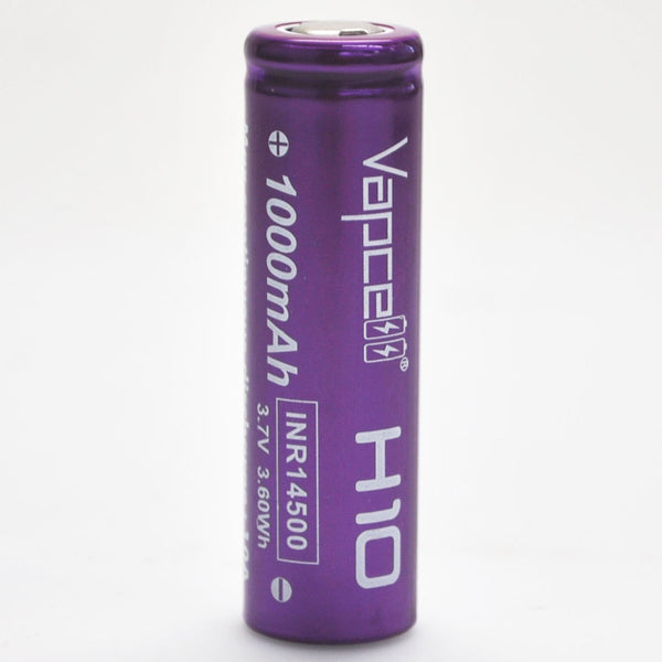

Mine are Vapcell 14500's rated at 3A continuous, but the label on the battery doesn't say anything about a short burst rating.
For the record, I bought these for a laser that specifies needing 3A continuous. However, I already had another 14500 that doesn't have a rating listed on it. It's brand name is Sofirn, and came with a Sofirn flashlight I bought in the past. When I use that in my laser (a 700mw 520nm), it seems to work as well as the Vapcells do. That's what led me to wonder if the 3A cells could possibly work in a 6A laser, if only in short periods of maybe 10 seconds or so.

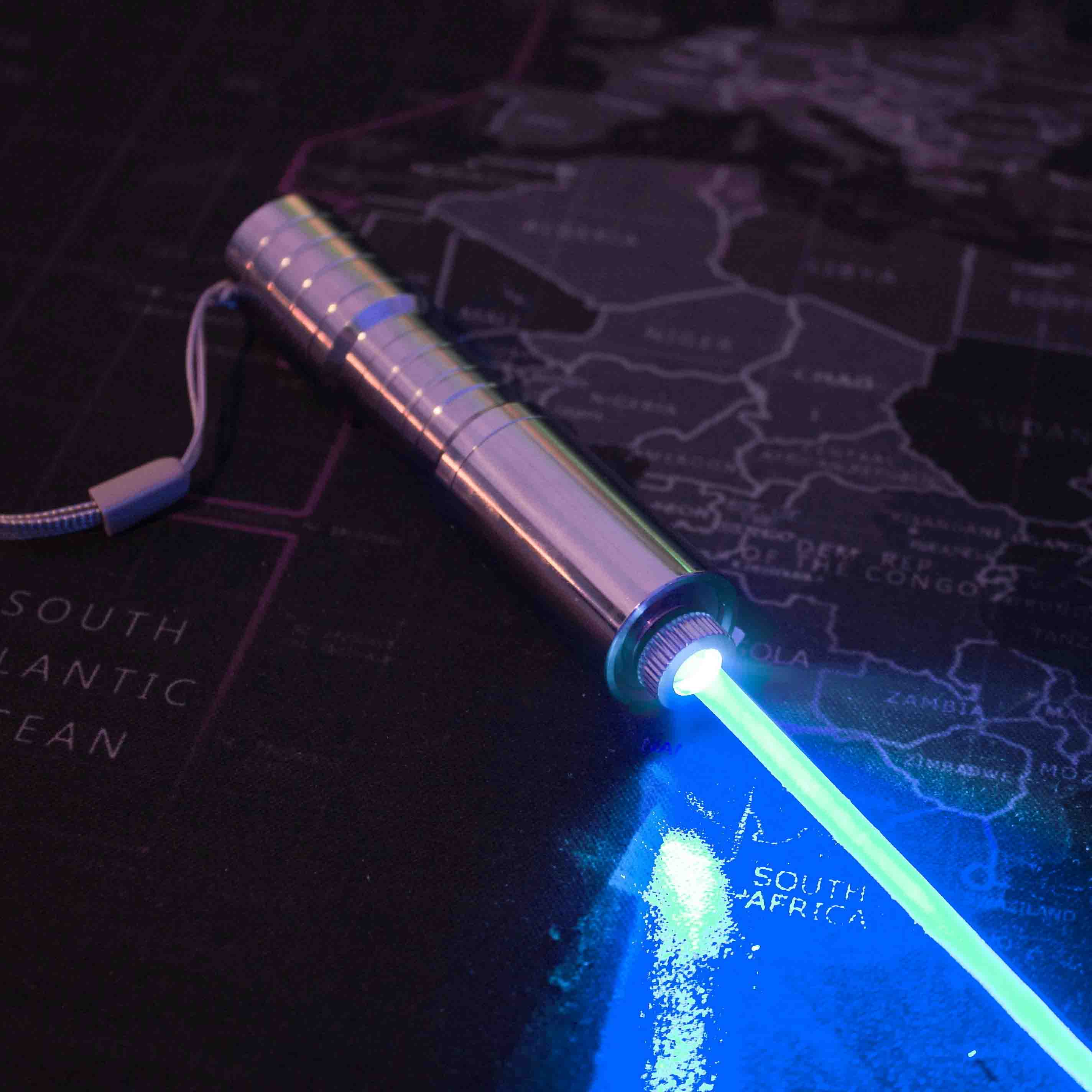

This one:
Oh, I'm aware that 6A and more can be bought. I'd do that later on but was just wondering if the 3A versions I already have (which I bought from the website you linked to) would operate the laser in question without causing the battery to become dangerous--especially if used in just short periods, say maybe 10 seconds or so at a time.

My battery shows it's an INR configuration.
I'll eventually get the right battery after getting a laser, but I wanted to wait until after it arrives before ordering a special battery for it. In the meantime I would want to use what I already have, but only if it would be safe.

Maybe not guarantees, but I'm sure some here have tried it and have experience as to whether there were any ill effects, and if the laser performed as well as with the "correct" amperage. I was surprised after getting the 3A batteries I have now, trying out the "lesser" battery I have with no rating seems to work the same as my 3A Vapcells. I even ran it tonight on that battery for about 30 seconds and then took the battery out right afterwards to see if the battery had heated up. It hadn't. The brightness was the same as with the Vapcells too. So that's my experience.
But as I mentioned, my older Sofirn battery doesn't specify an amp rating. I asked about using it back in April of last year before I got my current laser that requires 3A. Here's the thread where I started writing at post #5: https://laserpointerforums.com/threads/battery-amps-and-brand.111321/#post-1625020
From what I understood from the graphs Gryphon posted, the Sofirn shouldn't be able to perform even close to what the Vapcells are capable of, but I've still had good experience with it. But I have no idea if the difference between the Sofirn and Vapcell is as small of a difference as between my Vapcells and a newer 6A version.

Be carefull with the duty cycle.
I believe JLaser is over rating it. You have a SS host and a small 12 module, even if it a copper module he's rating it at 30 seconds on but a good 5 minutes off.
I wouldn't do more than 20 seconds on.
He has a IR laser in the same host at 500mw and mentions a 100% cycle. No way on that cycle.
Same host with a 1.6W blue aand he's got it at 1 minute on:whistle:
