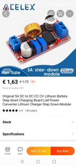

I want to drive a NUBM08 laser diode at 3A and make sure that it doesn't get destroyed. Originally, my plan was to do this with a linear regulator using the LM338, but then I have had many people tell me that it is quite stupid since using it at 3A would dissipate a lot of power as heat on the feedback resistor.
It was then suggested to me to use a "switching regulator" as a driver. Now, from my understanding this means that I could use a buck converter in some configuration that allows me to choose the current limit to 3A (but maybe this is completely wrong?). I am not interested at all on keeping the laser driver small, I would actually like to create the driver myself on a perfboard, but I don't know exactly what would be a good circuit for this task.
I have seen on AliExpress that they sell these cheap buck converters with a potentiometer to adjust the current limit (see image). Can I use these as a laser driver? If not, why is that?
Could you suggest a good laser driver that can provide a constant 3A which I can buy on AliExpress under 10$? (It doesn't matter if it's large).

Be careful with those buck regulators from china, some of them throw massive spikes under certain conditions. Cant remember which one, but I do believe it was the lm2596 based that were doing it, and it was during power up even after a safe current was set.
Some experimentation with a dummy load will be a must. 🍺

First of all, you're awesome, thank you for the help. Second of all... Could you give me a short explanation to why the chinese buck converter from AliExpress I showed would be bad? I mean, what do the ones you posted have that make them be almost 10x more expensive? Also, the last one you posted on ebay says only up to 3.5W so I suppose that I couldn't drive a powerful diode such as the NUBM08 or Sharp gh04c05b9g which are around 5W, right? (Or does that wattage refer to something else?). Again thank you so much for helping me

Laser diodes are sensitive to spikes, so drivers designed for lasers have protections built in that the general purpose dc to dc converters don't.

And an explanation: The actual topology that the aliexpress switch mode supply uses is not fundamentally wrong, rather the component choice and cost-cutting measures are bringing it down from its full potential. What do I mean by that? Well, it is a normal CV (constant voltage) IC that has an additional circuit with it to add a constant current feature(here is a video on how it works and how you can DIY such a circuit.
) Now there is nothing wrong in doing that and in fact, that's what most hobbyist grade CC drivers do but the trick is that it requires very careful component selection and math else it is going to be very unstable and have obscenely high current ripple and voltage ripple(voltage ripple = voltage change in millivolts or volts over a period, same goes for current ripple)
Now that the area where chinesium falls short, usually the chiniseum switch-mode power supplies have very high ripple, I have tested some to be as high as 1v p-p (very bad for diodes, you at minimum want sub 100mv p-p to ensure diode longevity and 'happiness') and that's down to the cost-cutting that enables them to cost only dollars a pop. Also, dedicated drivers will have a feature called soft start where they raise the current up to their set instead of starting at their set current, that soft ramp negates current overshoot.
PS, Regarding the question you asked, Yes and no, W is a measure of optical power(when regarding lasers), rating a driver by that is plain wrong, drivers are and should be rated by their maximum current output, diodes too if you look at the datasheets the manufacturer gives you a maximum operating current.

Thank you so much for this explanation, it really helps! If space is not of any concern, would adding a bunch of capacitors in parallel on the output of of one of those cheap chinese drivers be of any help to reduce ripple?

Not really and it is not really voltage ripple being the problem here (although it is a factor) Rather, the current ripple is the problem and that cant be mitigated by capacitors.
