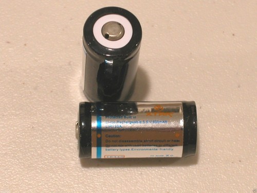

Thank you. Pics..... Remember - these are the "crappy" ones that came with the Amazon kit....... but to be fair they did send 4 of them.

Dec 15, 2014
6,787
Hi,
There no way that these are 1500Mah 16340,s That BS Chinese sales pitch.
The highest is 850, 700 MaH . There is not enough capacity in that small battery to hold all that. Sorry that what I think.
Rich:)
Definitely mislabeled. I think you need to understand a few things about these batteries. Even if your laser requires more than the capacity of the battery that doesn't mean it won't work. It just means it wont last the full hour. mAh means milliamps for an hour. That's what the capacity means. These batteries are capable of handling much more than that but won't last for an hour doing it. Does that help?
Ummm..... yeah I think so. (??) Essentially my problem with the batteries in the photo I posted is that after just a few uses and recharges - the "beam" of the laser is obviously getting weaker and weaker with each use. - I don't use my laser for 10 minutes at a time or anything.
I just knew by instinct that it was time for me to order some "real" high quality 16340's to replace the crappy ones and I wasn't sure which brand was good / and then on top of that the mis-labeling of the crappy ones saying 1500mAh was throwing me off because I couldn't find any rated like that. (Now I know why > misleading wrapping)
So, bottom line, if it was *YOU* that wanted to order 2 - 4 "Good" 16340's / what would you order? And a link would be most helpful. Yeah I think we've about cleared up my confusions here. Thanks.
**EDIT** Almost forgot, these crappy batteries in the photo are definitely button tops / not flat tops. Thanks Again guys.
