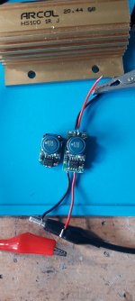

Anybody know where to heatsink this. I think the control chip on the bottom
Both of the SOP-8 are fets, Seems like a CV SMPS with current sense using an opamp, not a good one considering the price first Fet that goes to b- is just there for reverse pol protection, One of the SOP23-5s is the switching controller, 90% sure its the LEDA one.

Seller said input voltage 3 to 5 V. Is that possible? 3.5 W and 4.5 amp?
I think it only puts out 3.5 amp. Just wanted to see what this is. Probably, not any good.

I have several of them, mine are 3 mode and a few showed up single mode, 3.5a output and the 3 mode also has a low which is rapid pulsed like a led flashlight so you can only see it when swirling your beams spot on the wall and a slow pulsed mode intended as a strobe mode, I never heat sink any of mine and they work just fine.
-EDIT-
Supply voltage is 5.8 - 12.0v but I suggest 2 x 18650

The seller has no idea what he is selling! He thinks the input voltage is 3 to 5 volts! Do you have to heatsink the controller? There is another component on the same side which is taller which makes it harder to heatsink the controller next to it....if it needs it

I don't heat sink these drivers and I have run them for at least 10 minutes continuous duty with no issues, are you building something for continuous 24/7 use ?

I got a few of these and as red says they work great,if the 3 modes dont bother ya.
I power a NUBM44 at 4.5A with 1 of these in a small host with trimmed pcb to 18x11.5mm.
as for 4.5A as its 3.5A driver playing with parallel sense resistors results in your desirable output as mosfet is good for 10A
