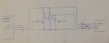

A circuit that I design to level convert 0-3.3v to 0-5.5v is this one.
Works quite well and can be plugged directly "on the wire".
On breadboard it works, I have to try it live. Unfortunately there is a small issue because the zero volts are not really zero (but near 60mV) because of Vce.
