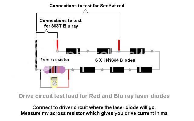

Also you are measuring it wrong. You have to take the test across the resistor Like so:
But using 4 diode instead of the Six you see in the picture.

You need to use the 2000m. In order to read the currant in 1 increment. With a Proper TestLoad.
Iam telling you to use a testload. Like in the picture above. If you make one false move doing it the way you are or do something wrong you will be out 50$ rather then <10$ for the test load if it will even break the testload & to be Honest i have NO Idea what you are doing to test it.

Also You said you made a testload with a few diodes. That makes no sense. Please post a picture of this testload so i can see what you have made.

When i first created the circuit, i used a testload. It is 4 diodes and a 1ohm resistor. I basically followed that same pic you posted. I had found it while researching how to make this.

Don't ever measure between the diode and driver!!! You can easily kill your diode. You measure across the resistor in your test load in mv not ma, and with a 1 ohm resistor 1mv=1ma. Hope this helps.

A resistor drops voltage across it, so You measure the voltage it drops not the current. It just so happens that the voltage drop across 1 ohm resistor in the test load equals the current flowing through the circuit. That's very convenient for Us since We need the current, and the voltage to the diode is no biggie. You can use other values for the resistor it is not a 1 for 1, so You have to do a bit if math to correctly figure the current.
This is a simplified explanation, but I hope you get the jest of it.
