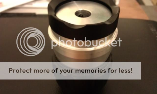

I have been working on a DRY host build for a while now and with some support from none only our resident "Pro" Lazeerer, I've produced what I call The Black N' Black or B&B for short.
Using the 9mm 445nm diode from DTR (thank you) I was hoping for a very efficient diode (like we all do) and while I didn't get the top dog diode I am very pleased with what I recieved so if your thinking about pulling the trigger on a 9mm diode DTR is the man.

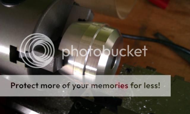

I got busy on the HF lathe after receiving the 2.25" bar stock

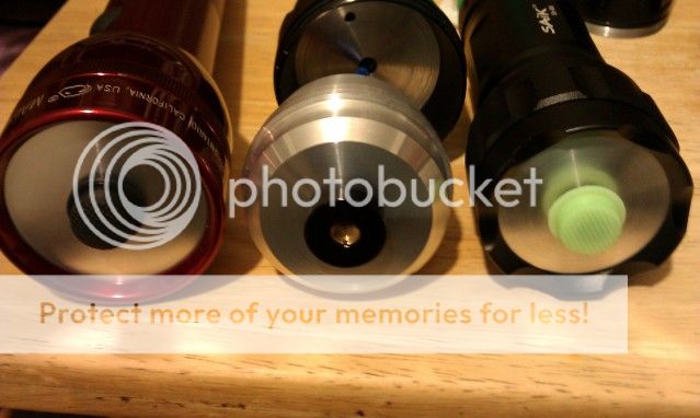

The sink turned out as big as the head of a Mag-Lite
:wave:Here it is in a sAik host head
The driver is... well... moving along, it's a buck and it's set to 1,829mA this current I chose after binning the diode and seeing how efficient it was/wasn't.:shhh: I'ts a X-drive:thanks::wave:
I used 3x18650 Pan. from Larry who got them to me very quickly thank you for that:thanks:
Using the stock lens I had 2.3W at 1,829mA... I could have push it harder with marginal gains and even used the G-1 measurement which was >2.45W. I'm happy with those numbers it should last a while at that setting (sorry no freezer test):D.
I'm happy with this build it's a burner for sure, though it had some problems. I originally wanted to utilize the aluminum plate at the bottom of the head for a dual driver build, but went against that. I'm going to try a different route on the next one:evil:. Here is a shot of it lite up, sorry beam shots won't do it justice until a can get a better camera.

Nice clean build bro. That heatsink came out looking pretty sweet in that host. I love the look of heatsinks that pass the outside of the host and taper down. It must be a real whopper to match a maglight like that XD.
Where did you get that host from?

This is beautiful! You definitely got some lathe skills!
Glad you like it I have just learned how to use it so I'm really thrilled about my new builds. Oddly enough my next sink is going to be made by someone who is very good on a lathe.:whistle:
