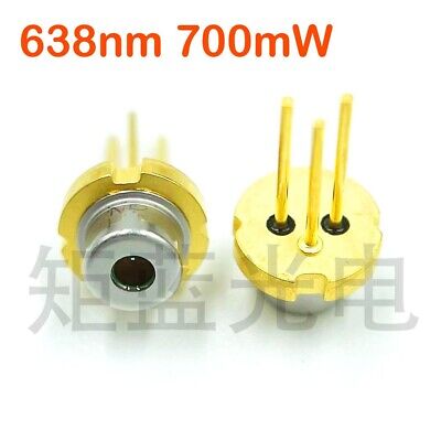

For my next build, I would like to do a red laser, what wavelength is most popular?
Is there any thats more visible?
This seems to be the brightest 638nm diode I can find, its a Oclaro HL63193MG
Im assuming most of the generic red lasers are typically 650nm?
638 nm is a fair amount more visible, power for power, compared to 650 nm, so for red that wavelength (IMHO) is the best choice between those two. Of course, when at the same output power 532 nm green is far more visible than 638 nm red because the sensitivity of our eyes favor the green wavelengths over red or blue.
The next thing to consider is whether to choose single mode or multimode, single mode will travel much further with less spreading, for a given lens/beam diameter, compared to multimode.
What's more popular? Due to the brilliance of 638 nm compared to 650, it wins for most members. But to each their own, if you like a deeper cherry red color that's also fun.

Don't get the Oclaro as it fails too easily. The Mitsubishi ML501P73 is a much better choice, but both diverge horribly. I have some 400 mW 650nm reds using the LPC840 diode. It is a single mode diode so you don't have the line instead of a dot in the beam profile.

OK, that helps anyway. I found another diode called the USHIO HL63613.
Anyone heard of this?
Typical divergence of 20 and 45 is not so great, but unless single mode they won't be. Inexpensive diode from some sellers, so who cares, put it in a pointer and have fun. Laser diodes are consumables, especially so the way we over drive them, have fun, then replace.
If you want a powerful 638nm red laser I'd stick to the Mits ML501P73 as they hold up better than the others we've had. That diode can be pushed over 1 watt, but the Ushio, not so much.

Yes ,Yes get the Mitsu they are way more hardy that the 700's and you can get at least 1W out of them with good heat sinking. Yes as said the divergence is crappy but you have a choice of lenses to choose from for that .
